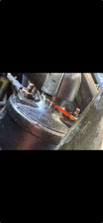

From there I just happened to see out of the corner of my eye the coil arching out. It was coming from the postive wire to the center of the coil. I removed the coil and for whatever reason I had it upside down and there was liquid leaking from the center of it.
Do I just replace the coil and see what happens? Or did something further down the line fail and cause the coil to fail?

This is where the coil was arching out
Ayuh,...... That's where I'd start,.....
