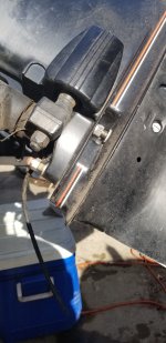

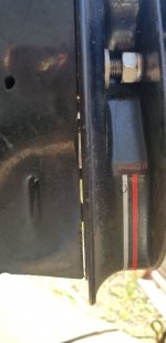

pictures or serial #
Serial #: A953921
One pic shows the front center nut and port side. The other side is identical and the 4th bolt is at the back, under the trim tab
The other pic shows how much gap I have managed

Interesting. What I see under the AV plate do not look like the have slot for screwdriver or shoulders for wrench.
How do I access them?

Closer inspection proves you to be spot on. An odd type of nut to me but I found a socket that got them off and the LU quickly followed.
Thank you very much
