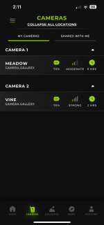

Throw some decent double AA in it and see how it does for a couple days

Interesting. Your signal strength varies a little between cameras. Mine phone display stays at 3 bars. Even when there is no battery power of any kind....🤔 That lead me to believe it wasn't an active icon.
Why was it showing signal strength w/o power?

As we speak it's showing 2 bars. So it has changed.... 1st time I've seen it under 3.......
3,935
Both my tactacams display varying bars at varying times. Doesn’t seem to affect the performance at all. Having used almost all brands of trail cameras the tactacams are by far the most quirky when it comes to the quality of SD card used. I’ve had a few issues using cheap or used cards. Wish I could remember exactly what I have in them now. I know they met camera specs are quality cards.

Does the app show battery charge?
3,935
Great pix! Ya, I've noticed it too that nighttime pix can be fuzzy. I think for $9 a guy can get 50 HD pix that sharpen them up. I also turned my flash down to low. Went down to the camera a few minutes ago and it's still fully charged.
Yes look at my pic above. You’ll see a battery icon with a percentage.
