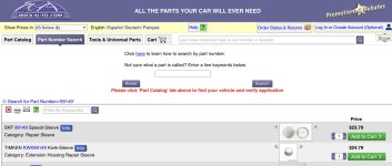

With your part number, check with rockauto.com. $23 plus shipping. And the permatex aviation sealer is what I used as well.
to install it, I found an exhaust pipe transition piece that fit the sleeve perfectly for $5 at oreilys auto parts. Plumbing pipes were either too big or too small. Use what works
