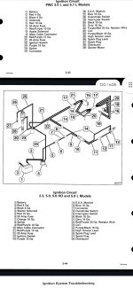

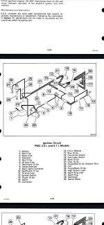

I do have the service manual and it covers everything for my system, except it skips over the 4.3 wiring diagram for some reason. It covers all others but 4.3 isn't listed, just the two photos attached.
