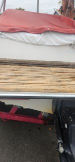

My 1992 Four Winns Horizon 200 has a nice Teak swimstep. It does require regular maintenance to have it looking its best. I have used Teak Oil and occasionally Teak cleaner and then Teak oil.
I did not use the Teak oil this time, so I do not have a picture. I did not use any varnish this time.
After the Teak Sealer, it looks good but could be better. I'd like it shinier.
What do you recommend?

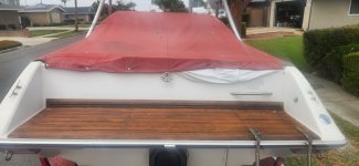

Thanks. Re Teak being out of vogue. That may be the case for a new boat but the teak is what's on the boat now. I'm not going to replace it, I just want to make it look good. Here is a picture after doing 3 things: Teak Cleaner and Brightener, Teak Sealer and Varnish.
It looks great now. I plan on making a cover to protect it from the sun. A mechanic told me it may yellow or peel. Why would it do that? The varnish is made for boats.
Any suggestions to keep this looking great?
