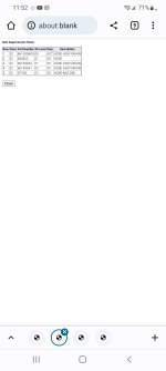

Yegboats
Feb 20, 2016
527
The original 87108 was just a molded hose, eventually there was a drain plug added and the part numbers superceded a few times over the years.
