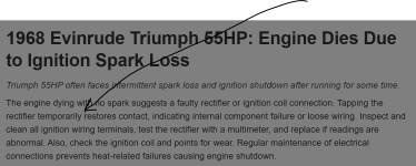

btw this dead ended case may point... may point to a flaky rectifier connected to the stator yellows.
who knows....a bad rectifer may be influecing the B+ outpout that spreads to the engine distribution and.... your power pack ... try disconnecting it as a quick test.

1968 version ?? in referrence to these "options" keep in mind anything affecting B+ fed to the amplifier is susceptible of interring with spark generation.. resistive points, loose -chaffed wires anything from battery B+ to amplifier..... don't mean to send you of a goose chase but.....recheck evrything.
