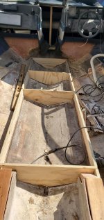

My enough mount stringers were bad so I cleared the area last year and I just cut new ones last weekend.
I cut a section of the floor out to see how long they went and the more I cut, the more bad flooring and stringers I found.
My question is, it looks like there is only 2 factory stringers on the hull.
The original engine stringer was 2 2x6s sandwiched together. 1 2x6 was the length of the bilge box and the other stringers was a longer 2x6 that ran to around under the dash/steering wheel area.
I now have the whole floor taken off and I still don’t see signs of any other stringers.
There looks to be like a random 1x2 or 2x4 on the sides that someone just wedged in there.
The new engine stringers I cut are from a 4x6. I cut the 4x6 to match the 2 original 2x6s.
My question is, do I just add the new engine stringers and glass them over with new plywood?
Do I have to add ribs?
A second set of stringers on the outsides?
I used the boat like this like 6 times and it didn’t break, and I don’t see where more stringers would have been installed at the factory.
I still need to remove the foam.
The center red lines represent the engine stringer and the outer lines represent where I think someone else put a 1x2.
Thanks.

What kind of OMC drive do you have? Many boats only have 2 stringers, most have some bulkheads too

This is how my setup was, albeit my boat may be smaller because my stringers were 3/4" plywood. As you can see how stringers, bulkheads and engine mounts are ties together to form the spine "structural part" of your boat.

Just an FYI ....laminated plywood will be 5x as strong as a cut-down 4x6
I would have just laminated 3/4" plywood to 1-1/2" myself

My plan was to install the new 7ft stringers and put fiberglass over them and then put 3/4” plywood side to side for the floor, screw the plywood to the new stringers and then put fiberglass over the plywood and overlap the new fiberglass onto the sides of the boat.
You pulled out a 9 foot long "bone" and want to replace it with a 7 foot long "bone"?

Laminate the stringers. Make them 9' long or longer
That’s what I’m going to do.
I’m also going to add some bulk heads like the ones in this photo and put fiberglass over them too. For the plywood floor, I just screw it into the stringers and laminate it all the way to the sides of the hull so it is bonded to the hull?
That looks good.
I’m going to add bulkheads like your boat.
Read links 14, 15, and 18 in their entirety.... All your answers are in the stickies

Whatever pieces of plywood you cut to a final shape. To be installed in the boat. COAT ALL surfaces with a thin coating of just liquid glass mixture.
All surfaces out of sight WILL get wet from water as it get into each compartment. Remember to cut a BIG DRAIN hole on the very bottom of each bulk head to allow POSITIVE draining for each bulkhead compartment into the bilge pump compartment.
Glassing the long stringers ? That is up for discussion. Reason ? Depending how much flexing ........they will do ? Big hard impact wave flexes the bow section areas ? Migh be next to no flexing with enough....THIN PLYWOOD ...... bulkheads. They do not need to go from keel to top deck. 3" to 6" wide RIBS would be over kill but provide plenty of resistance to bottom and side flexing.
We have made strong lightweight plywood ribs by overlapping 4 separate pieces of 1/8" to 3/16" thick plywood. WE we made the over lap areas about 3" to 6" areas. We screwed them together in the hull with about 4 screws. S S is not needed. The 4 screws are used as relocating screws.
We dry fitted ALL the ribs in the hull with the screws. Them removed all the ribs. Unscrewed all the rib sections. Coated all the surfaces & edges. Reassembled all the rib sections with the 4 screws. Let them harden for several days. Notched the ribs to slide down the stringers. ? Small strips of glass cloth wedged into the corners. Or small pieces of triangular blocks with glass as glue. Locked the ribs to the stringers. NEATNESS is NEVER required below the deck areas !!
Do a dry fitting of the completed ribs to cut off any excess top height to clear the top deck. 2" to 4" below the deck is fine.
Think out the steps several times. Fiberglass glue demands that if possible.
The hull survived all the years without additional bulkheads or ribs.
Your call on any extra reinforcing. Make the repairs enjoyable. (y)
I would coat the long stringers completely after they have a good dry fit.
WE had to cut to shape and scarf 3 or 4 pieces of boards to fit them to the upward hull curve. Yes it can become tedious to do some repairs. But if you like the hull ? Do the steps with a feeling of accomplishment.
